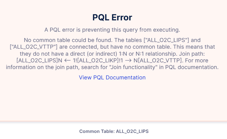

When I try to add fields from all tables into one studio table I get the following error:
I have understand the problem but missing the best approach to solve it.
What do you think? Is the a studio table with different PQL formulas the solution? If yes, how can I do it?
Or is it better, when I create a table (e.g. TAB_PROCESS_FLOW) within the transformations that includes all the key columns and connect the other tables (VTTK, VBAK...) within the data model. So the table TAB_PROCESS_FLOW is like a case/common table.
