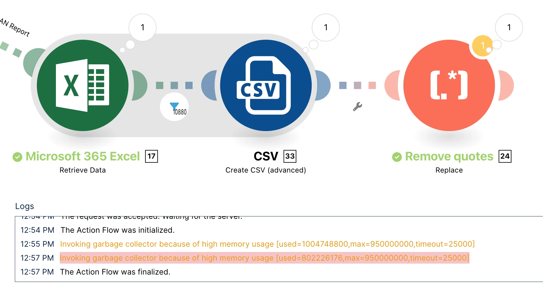

I am reading an Excel file of 5 rows and 30000 rows and create a CSV out of it. The Excel file is as small as 600 KB. Between Excel and CSV module, I have a filter (to exclude empty rows).
By modern standards, this should be a very trivial data processing step. But during the processing of the filter, it’s extremely slow, and I get the warning:
Invoking garbage collector because of high memory usage [used=802226176,max=950000000,timeout=25000]
I enabled “Enable Data loss” but it didn’t help. The scenario runs in the end, but the fact that it stumbles on such a small data volume makes me feel like it will fail at some point. Why does Action Flows struggle with such a small data amount??

The warning you're seeing is typically caused by the Action Flow reaching the memory limit during an aggregation step, rather than the Excel file itself being too large.
From what I can see, the filters are being applied after the Office 365 Excel file is retrieved. If possible, apply the filters before processing the file, as this will significantly reduce the amount of data being handled and lower the memory usage.
Although 30,000 rows is not inherently a large dataset, the combination of Excel parsing, row-wise filtering, and CSV aggregation within Action Flows can still be memory intensive.
A better approach would be:
  • Apply the required filters before reading the Excel file.
  • Process or aggregate each filtered subset separately before generating the CSV.
This should help reduce the memory footprint and avoid the aggregation limit.

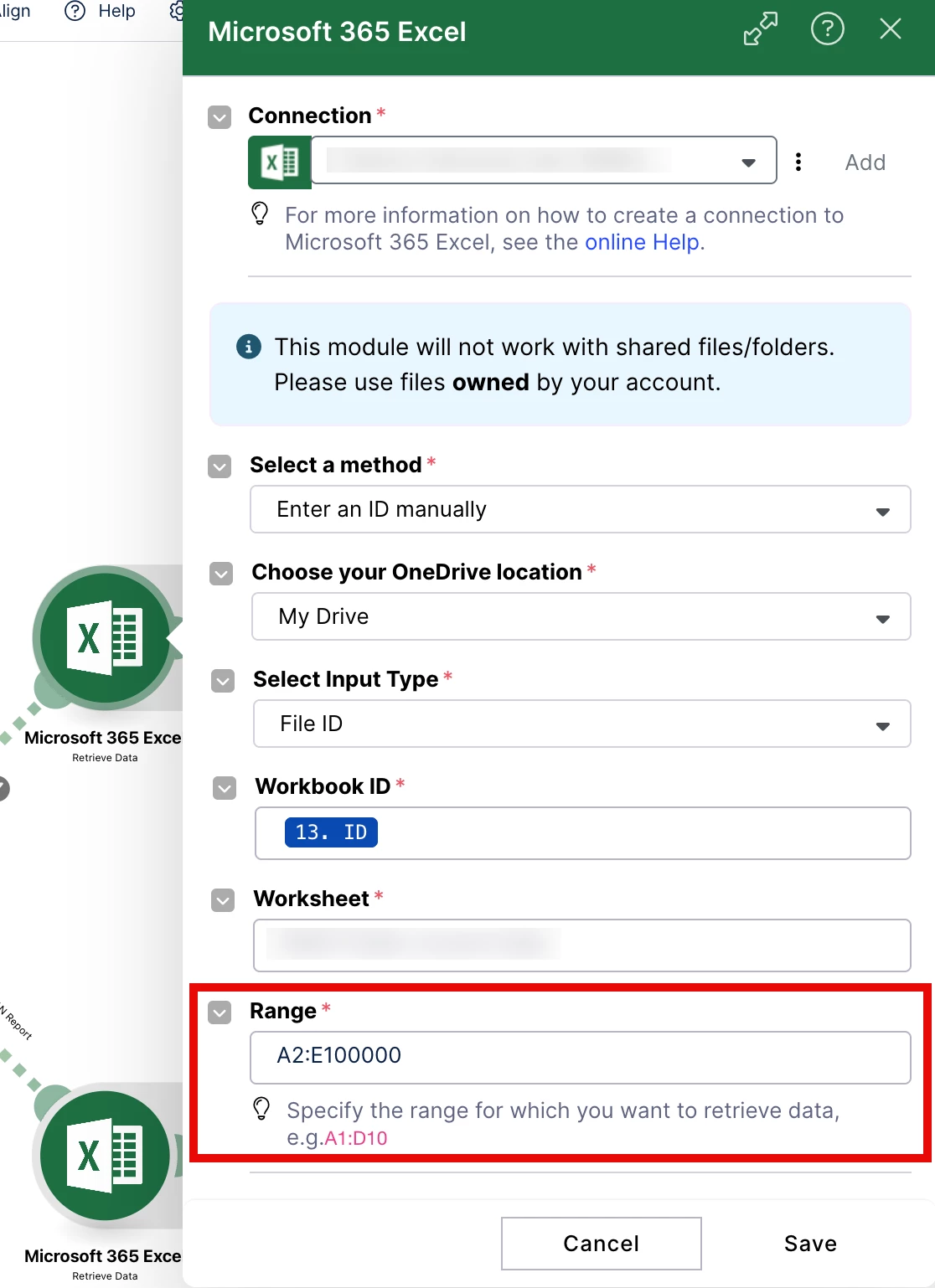

How can I apply the filters before processing the file? The Excel “Retrieve Data” module doesn’t support any filters. It can only get a certain range.

What I meant was filtering the Excel file before it is pulled into Celonis, i.e., reducing the data at the source if possible, rather than filtering it within the Action Flow.
Also, I would recommend not keeping the retrieval range too large. Even if those rows don't contain any data, the Action Flow still has to process and check the entire specified range, which increases memory consumption.

No, unfortunately we cannot touch the incoming Excel. That’s exactly why we are using Action Flows: to process an Excel we cannot modify and bring it to the form we need.
The retrieval range is so large, because we cannot know in advance how many rows it will contain. It’s a list that grows over time. That’s why I have to retrieve a big range, and then in the filter, I filter out the empty rows.
