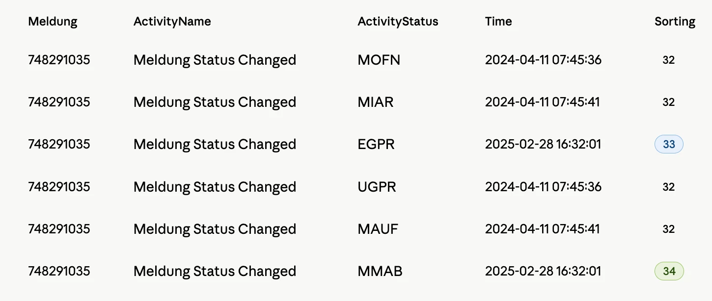

To give an example, I select only the activities for Meldung number “748291035”:
The way I want my activities to be ordered is like this:
  • Time
  • Sorting
  • Alphabetical order for ActivityStatus
So the order to be: MOFN, UGPR, MAUF, MIAR, EGPR, MMAB

I notice that after the transformation is ran in the Data Integration, my table is not ordered, so I think ORDER BY does not work in here.
So the question is, how can I order the activities?

Hi Stefania,
The Sorting column is the right mechanism — but it only works if it is explicitly mapped as the activity table’s sorting column in the data model / event log configuration. If it is not mapped, Celonis can fall back to undefined ordering for same-timestamp events, and in practice that often looks alphabetical by activity name.
So for your target order, you should assign numeric sorting values, for example:
- MOFN → 1
- UGPR → 2
- MAUF → 3
- MIAR → 4
- EGPR → 5
- MMAB → 6
and then make sure that column is configured as the activity table’s Sorting field. Lower value = earlier activity

If the sorting column in the UI is still causing issues, the easiest fix is to add fractional seconds directly inside your SQL transformation.
Since you already have your sorting logic (32, 33, 34), you can ad a tiny time offset to your timestamp based on that rank. This forces Celonis to order them correctly without relying on the UI settings.
For example, you can change your timestamp calculation to this ->
CAST(JCDS.UDATE AS DATE) + CAST(JCDS.UTIME AS TIME) + (
CASE
WHEN COALESCE(SS.TXT04, US.TXT04) LIKE '%EGPR%' THEN INTERVAL '0.001' SECOND
WHEN COALESCE(SS.TXT04, US.TXT04) LIKE '%MMAB%' THEN INTERVAL '0.002' SECOND
ELSE INTERVAL '0' SECOND
END
Adding a millisecond offset ensures the events display in the correct order in your Process Explorer, without changing the actual dates in your charts.
