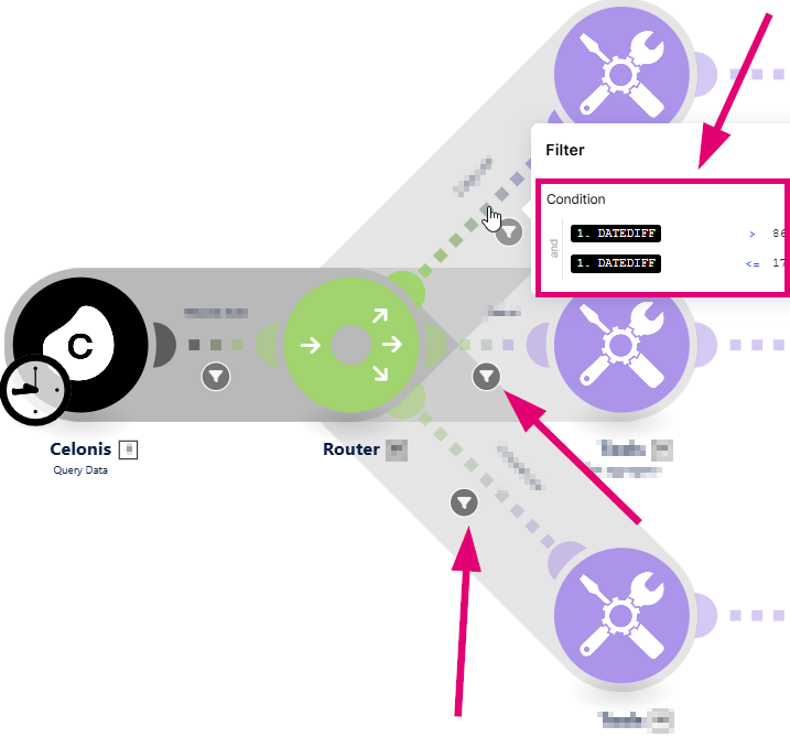

bunyod.sap
Level 7
  • Level 7
  • May 6, 2025 7:54 AM UTC
Hi ​@emil.vakhi12 If I understood this task properly then you can solve this issue as follow:
For the whole automation you need Action Flow and Skill components. In the Action Flow part - you start the chain with the Query Data Module. There you create amonth others a field with condition DATEDIFF(ss, ("Table"."date1"), TODAY ()). Then you create as a second module a Router and (depending on all the requirements of the use-cases) it follows with the rest of the modules. Between the Router and the third Module (whatever that it will be) you may apply the Filter which you wish to have. So that it will be send to the respective group. Cheers, Bunyod
