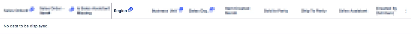

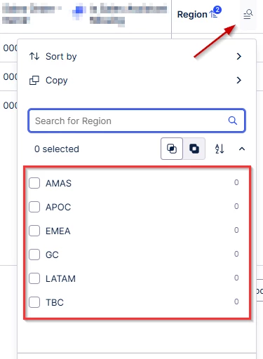

Hi all,
i got a strange issue. In view → table, i can see value “-” in column ‘Region’.
However, when I try to search it in column search dialog , i can’t find it.
The datasource of this column is coming from a customize excel sheet.
Can anyone help on this issue ?

My guess is that the value is not really a hyphon string “-” but rather NULL.
Therefore you can’t really find it in search bar properly.
If you want to filter by that I would sort by that column Ascending then it will show those rows on top. If you then click the cell it will create a filter on top saying “Region (blank)”

​@manuel.wetze  thanks.
Yes. You are right. after click the cell and filter shows ‘(blank)’.
So, the search bar properly won’t show ‘NULL’ in the list ?
And , if I keep this ‘blank’ values on the top filter bar and remove other filter conditions , i can’t see any results. Is it normal ?
