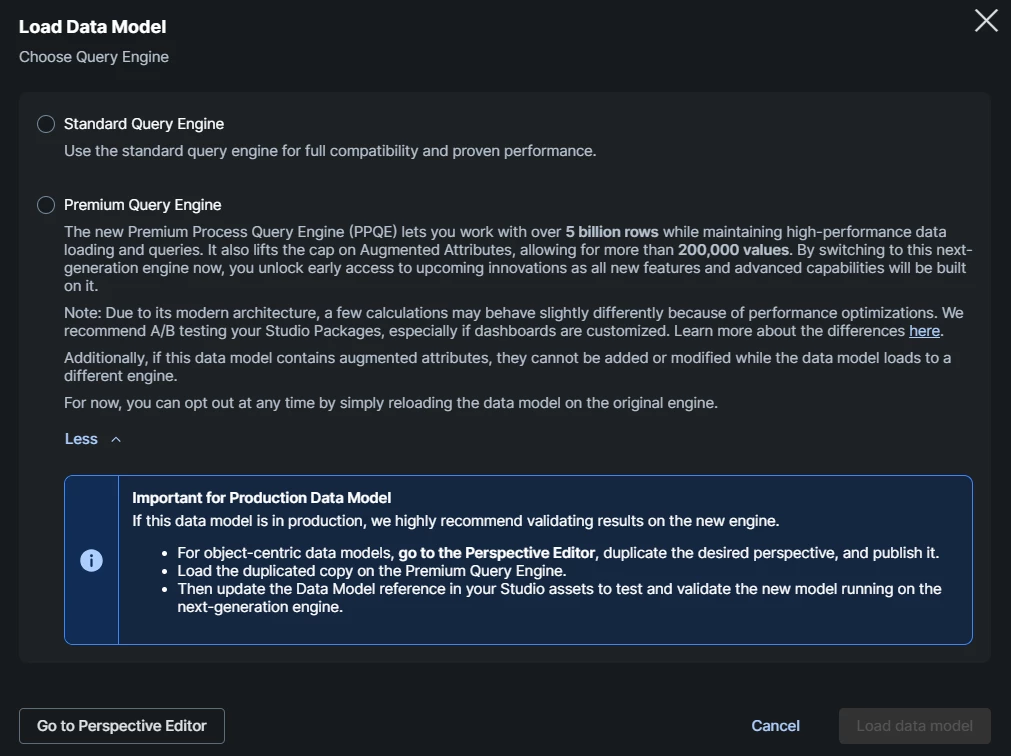

It might be that the Premium Process Query Engine will solve this issue. It’s currently being rolled-out for a specific set of Data Models.
Note, as the text mentions, there are some minor changes in how it handles logic, see https://docs.celonis.com/en/understanding-differences-between-first-generation-and-premium-process-query-engine-behavior.html
