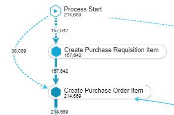

What does dotted lines depict in a Variant Explorer?

Hi Raman,
The Dotted Line Means : Connection to Start or End Activity
Solid Line Means: Connection between activities.
Hope this helps!
Regards
Ayan

Hi Raman,
Hope this helps!
Regards
Ayan
Forum|alt.badge.img+5
Here in this image almost 38k cases are going directly to Create Purchase Order, skipping the requisition activity. So that means almost 38k cases did not go through requisition and directly started from create purchase order?
That means , 38k records directly Starts from Create Purchase Order Item
