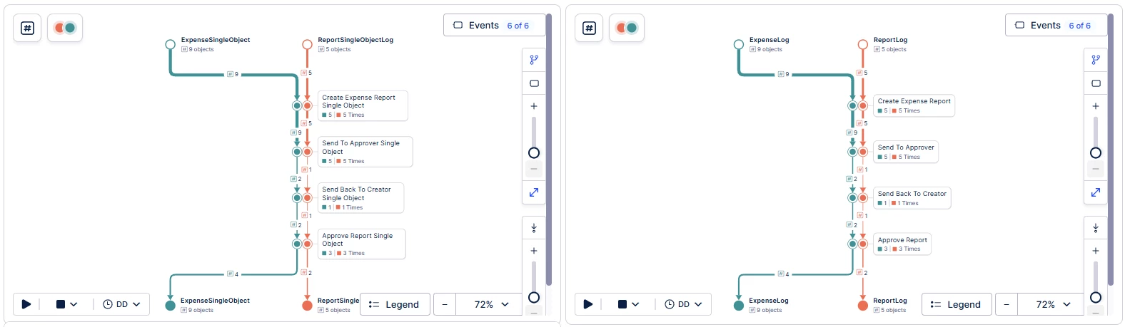

Hello,
I’ve just finished the OCPM training. In there you create objects with multiple object to object relationships and events with multiple object to event relationsships. So e.g. the object “Expense” has a relationship to the “Report” object and the event “Approve Report” has multiple relationsships, e.g. to the object “Expense” and “Report”. The resulting Process Explorer can be seen in the right picture.
As another test, I’ve duplicated the events and deleted all but one event to object relationsships. So each event has only one relationsship to one object. When displaying a Process Explorer with this Event Logs (see left picture), I get the same result as with multiple event to object relationsships. Also when filtering on tables with data from the source systems, i get the same filtered results on each of the Process Explorers.
Am I missing something or what are the benefits of multiple event to object relationships?
