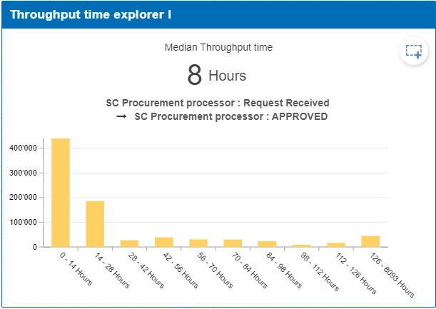

Hi,
How can I customize the he Throughput-Time-Search element in Celonis 4.5? - In the attached picture (TPT) the intervals for each bar is consistently 14 hrs. Can I change this to e.g. 50 hrs per bar? - Thanks.

I don't have a 4.5 environment right now, but, please chek if after double click on chart you have in "advance options", the partition rule option, if you have, use it to define explicit boundaries.

Hi Thomas,
the partition rule of the "Throughput Time Search" component is currently not configurable.
But as Francisco pointed out, you can achieve the desired outcome by using a chart component (in this example, the "Histogram Chart")!

Hi Francisco and Dario,
Thanks for your replies. Indeed there isn't any ADVANCE OPTIONS in the TPT Search component. I'll have to do it as described by Francisco.

Hi @1460043523
TPT component in celonis don't have such advance option as of now so you can use Histogram in place of that to define explicit boundaries.
As rightly said by Dario and Francisco.
