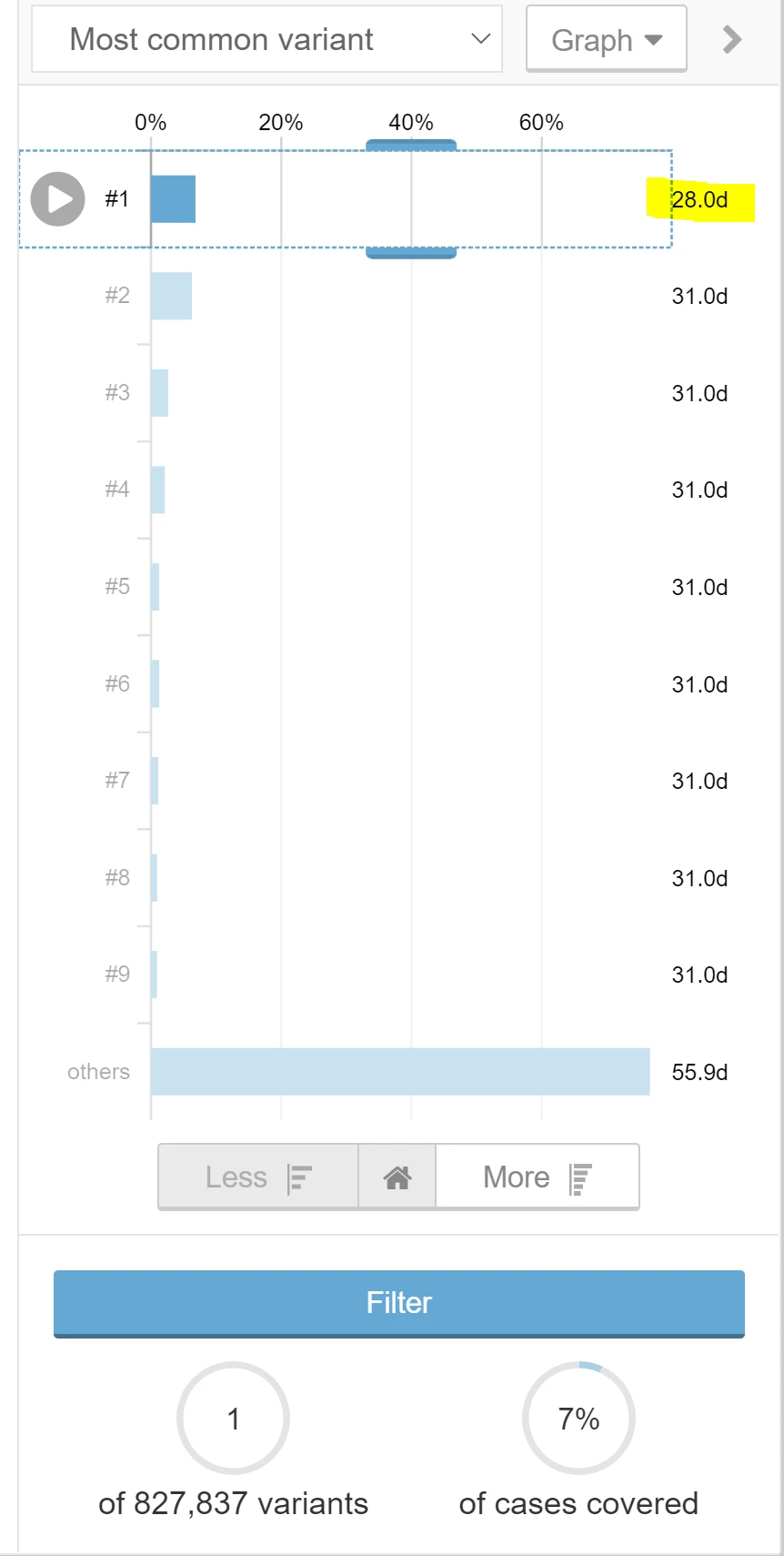

Is it possible to add the ability to customize the formula used for the Cycle time on the Variant Explorer?
  • August 23, 2021
  • 4 replies
  • 59 views
In the Variant Explorer (Process Analytics), the Cycle Time shown on the different Variants uses Throughput time from first activity to Last activity. Currently, there is no way to enhance the KPI to filter certain activities, like Date Markers (ie Due Date Passed). Is it possible to add the ability to customize the formula used for the Cycle time on the Variant Explorer?

Hi Quintin,
As far as I know this is not possible, but it is an interesting function! You can request features using the form on this website, by going to 'Customer Support' > 'New Case' and select here 'Feature Request'. Good luck!

Hi, @quintin.nel11
Like Jan said, it is not possible to do that in Variant Explorer. But you can create a component (e.g., a number) and define the KPI with PQL, by using process-related functions.

Hi Quintin,
Thank you Jan, I will create a Service Request for this.

Hi, @quintin.nel11
Hi Rul, Thank you for your response. I am aware we can do this in a Single number KPI, and we have implemented this, however, the cycle time displayed in the KPI measure and the Variant explorer is not the same, causing confusion to the users. It would be ideal if the option to enhance the CT formula used on the Variant Explorer to be consistent with the cycle time shown elsewhere. I will raise a service ticket as per Jan's recommendation.
