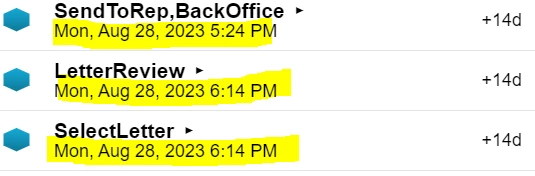

I have a time stamp in the below format in a spreadsheetYYYYMMDDHHMMSSMS.When i try to upload this sheet the MS part is cutting out. How do I upload timestamp with microseconds?

  • Sep 12, 2023 2:14 PM UTC
Thank you Guillermo!!
I do see the MS value when i run the query . But when i run a process explorer dont think Celonis is considering the MS values. Do you know how to fix that?
  • Sep 12, 2023 3:30 PM UTC
If I recall correctly, Celonis, by default, doesn't show millisecs.
To show it in, lest say, an OLAP, you need to format it specifically
I guess to show in Process Explorer you could create a custom KPI.
Anyway, I know that Celonis considers them. I remember having an activity table with millisecs and, although it didn't show them, the activities were in the right order (it was a transactional systems and most of the activities had the same hour, minute, second.. but different millisecs)

I have been trying with another dataset, and I was a bit wrong (my bad):
So in theory you can NOT show the millis in a data, but you can ADDa column with MILLIS() showing only the millis part.
Also, in AF you can use millis:
