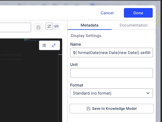

Hi dear all!
Coming a little late to the party 😁, but for future readers, In Views there’s is a workaround for this problem, specially if what you want in the column name is not a KPI but actually just a date. Several places already support “smart inputs” which allow you to write javascript expressions.
For instance, the following expression would give you the current month - 1, the same logic would be applied for further cases
${ formatDate(new Date(new Date().setMonth(new Date().getMonth() - 1)), '%B') }
You would add this on the “Name” field in the PQL Editor:

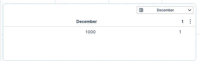

And then it looks like this when rendered on the view, in this case in a Table:
Hope this helps!
