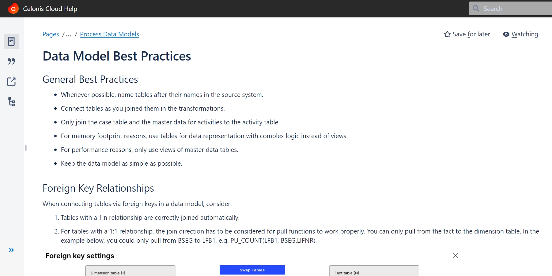

I got the following message. but I do not know how should I solve the problem. Could you please explain the detail?
Data model load failed during load to engine: Could not load data model. Load failed. Error Message: Could not execute foreign key join: there are duplicates on both sides of the specified key relationship. Table "A": key column ("E"), key ('00058B2D25244258B806'), rows 1 and 2. Table "B": key column ("E"), key ('EEE3E74B186040F48522'), rows 29 and 35. Celonis Support ID: e9012fd3-bf7c-4e59-9d7a-6b92484458a2

Hi Eri,
You are getting this issue because while joining the tables in the data model, it is not able to establish a 1:N relationship.
Here in your case, you have duplicates on both sides Dimension Table(1) as well as in the Fact Table (N).
Your Dimension table is Table A and Fact Table is Table B.
Try applying the Best practices while joining tables in a Data Model. (More can be found in the help section"Data Model Best Practices")
Screen Shot attached.
Hope this helps.
