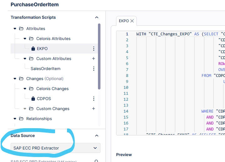

Is it possible to change the Data Source of the transformations of celonis objects (OCPM)?
Background: we have migrated a formerly external instance into our Celonis. Therefor we do have several redundant data extractions. I would like to consolidate them in one common Data pool (seperat of the other data pools). This means that I have to change the Data Source of existing celonis objects. But it seems that the Data Source is read only, once an object is created.
Is there any solution for that? ...up to now, my only idea is to create views in the old, original data source for each table, that is moved to the new common data extraction pool.
