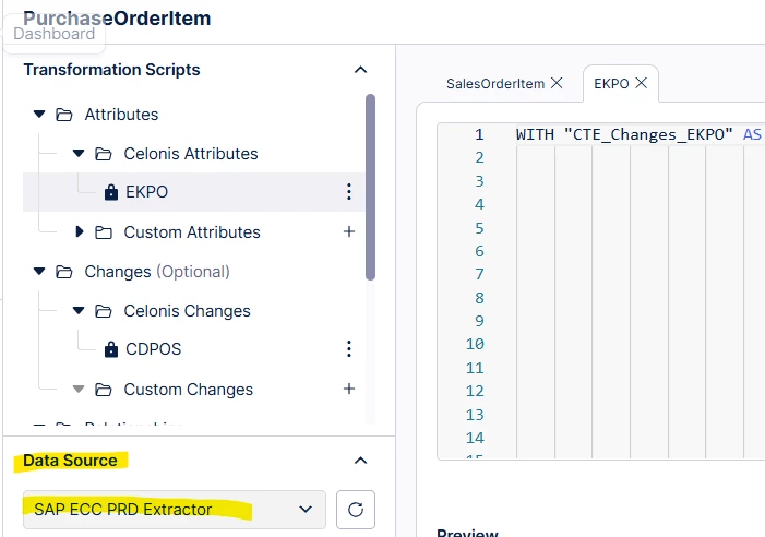

I asked a similar question some time ago, still looking for an elegant solution:
Context:
Currently we do all the extraction within one Data pool, that does also contain the OCPM objects and events. Since we start to connect additional systems, we want to use the approach “1 dedicated Data pool per system, 1 common Data pool for all OCPM objects and events data”
Problem:
I hoped to simply rebuild the existing extractions in a new Data pool and then switch the Data source within the OCPM-transformations to the new Data pool. This works totally fine for custom objects, but for Celonis objects the Data source is read-only:
What is the most “elegant” solution?
One approach would be to create a view for each table: view in the old data source pointing to the underlaying table of the new data pool. ...quite a lot of (maintenance) effort and not sure whether this would work.
Another approach is to create full overwrites of all transformations. But by this you loose the connection to the official catalog with its updates.
What would you do? Or do have Celonis Admins the possibility to change the Data Source (in some “God-mode”)?

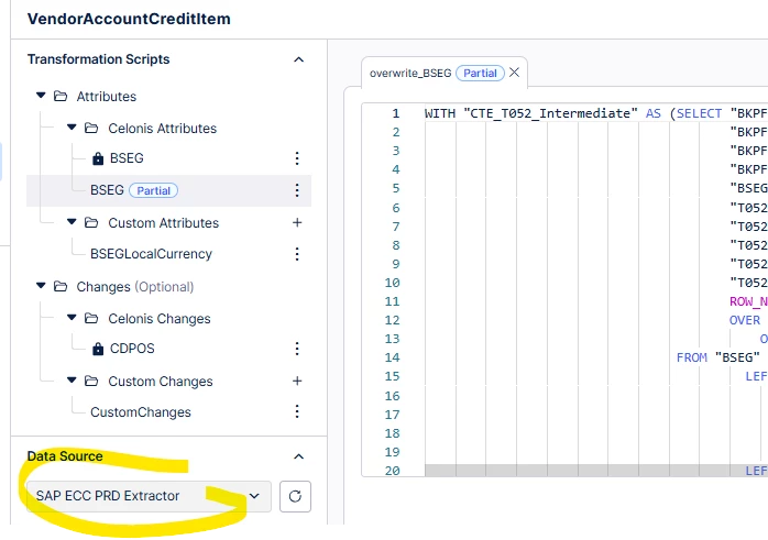

We do have the whole Accounts Payable process in place since 2 years. So there is already quite a lot adaptions to the catalog transformations.
Our custom attributes are generally on object level. But their transformations are bound to a date source (read only). Same for partial overwrites.
So if I change the data source (by adding the new one as described by you), I will have to manually transfer all these changes and enlargements of the catalog process manually. (Whereas for custom objects I am able to simply switch the data source)
...seems that there is no other way? :-(

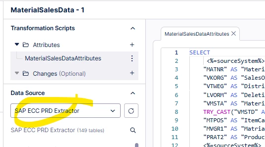

Celonis objects (data source is read only):
Custom object (data source can easily be changed):

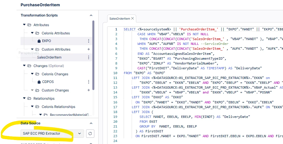

- in the GLOBAL scope of the OCPM pool, create a data job with one statement per
  table:
DROP VIEW IF EXISTS <%=DATASOURCE:01_EXTRACTOR_SAP_ECC_PRD_EXTRACTOR%>."EKPO";
CREATE OR REPLACE VIEW <%=DATASOURCE:01_EXTRACTOR_SAP_ECC_PRD_EXTRACTOR%>."EKPO" AS (
SELECT *
FROM <%=DATASOURCE:NEW_IMPORTED_CONN%>."EKPO"
NEW_IMPORTED_CONN is a placeholder, put your imported connection's name there.
- schedule that job before ocpm-data-job
global scope because that is the only scope that can see both the source data and
the target scope. your scripts keep resolving the same DATASOURCE token, the data
behind it now comes from the new pool.
the docs still send you to views for exactly your case, "Celonis-supplied
object/event transformations that hardcode standard table names and that you want
to keep untouched". they describe it against a dummy connection though, so doing
it on your live extractor connection is the part to prove. one table, ten minutes,
and you know.
