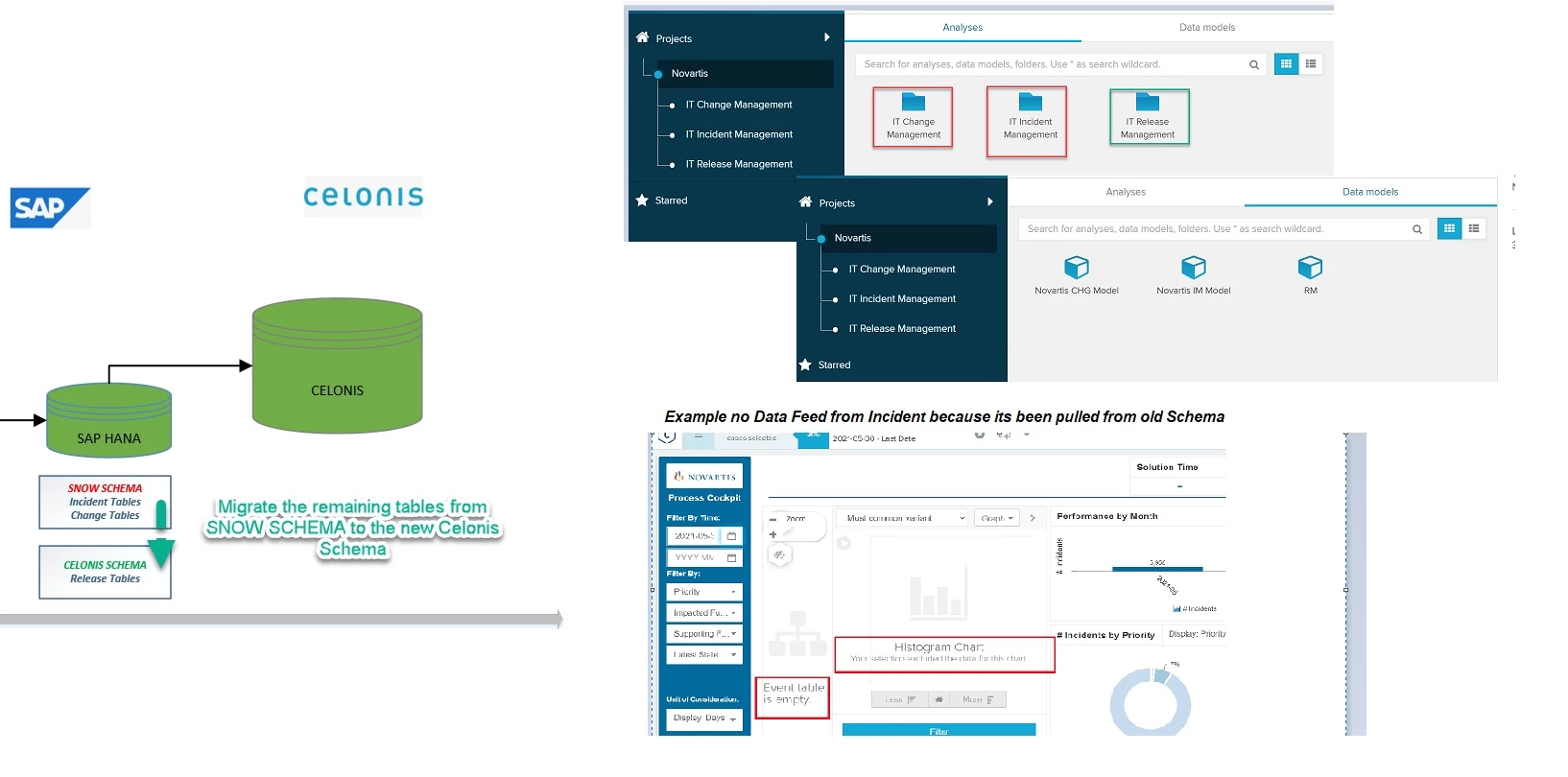

many thanks for your prompt and detailed response I’m still trying to piece together using the Celonis terminology, maybe I can further elaborate and show screenshots;
1. Our Celonis is an on premise solution connected via SAP HANA
2. today we are running 3 processes(3 analysis/data models); release, incident and change
3. the release process is been fed from a group of tables made that exist in the HANA, a schema called "Celonis_SCHEMA" this connection is working correctly
4. however the other 2 processes incident and change is from an older schema in HANA called "SNOW_SCHEMA" and the analysis do not have the latest feed the views are built but there is no connector feed (this is what we want to fix)
5. in the HANA the "CELONIS_SCHEMA" has all the updated tables and feed including for incident and change
6. we need to update our Incident and Change analysis to reflect the "CELONIS_SCHMEA" (newer)
7. Question, how do we make this configuration to change the source of an analysis feed from one HANA schema to another, (anything will help, knowledge article, screenshots) we would like to keep the same views but the connector needs to update even if we see how to change one example we can figure out the rest

Sorry I didn't understand you were talking about a Celonis on Premise. From your title, I thought it was SAP HANA... and of course, my description and terminology refers to an Celonis EMS Cloud setup, not a on premise one...
I have unfortunately no knowledge of the on premise setup, but I guess the logic behind is similar to the Cloud. From your screenshot, I guess that you have managed to connect, extract and transform data to build the new datamodel. And as such the data is there.
But your analysis is still reading from the old datamodel. So it is on the analysis side that you need to find how to update this link. There must be a menu that you can select the appropriate option from...
