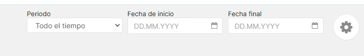

Good morning! I want to do a filter like the picture (this are the filters used in Conformance Checking sheet in Celonis Free Plan, in this sheet I can't see the format of the filter or change nothing), I try replicate but I can't do it. Could s

Good morning! I want to do a filter like the picture (this are the filters used in Conformance Checking sheet in Celonis Free Plan, in this sheet I can't see the format of the filter or change nothing), I try replicate but I can't do it. Could somebody he

Hi @sverre.klein11,
I'm using it, but always it's neccesary put two dates (start and end date) and I would like to split in 2 date picker.

Hi @sverre.klein11,
I see this behavior also, but i want split your date picker in two date pickers where viewer of this sheet select one date only, similar like this:
The behavior is the same that you show in the picture, but I like more this format.

Hi @pedro.pined,
Is this what you mean?
There is an option to put the date picker "horizontal". I then used text components to put Start date & End date above the date picker.
Kind regards,
Sverre Klein

Hi @sverre.klein11,
Yes, this is a option, but i thought that in the imagine that i attached it before, case start and case end is the title of the data picker. But your idea is a possible solution.
