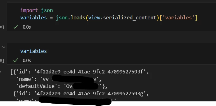

Level 10
json_dict() is where everything lives in terms of PyCelonis assets. Load the JSON packages to be able to use the loads function. Then call [‘variables’] and it’ll give you the view variables

Thanks! I think that might work. I follow your example, but I have this error:
I’m not really sure what I missing.
matt.witty13
Level 10
That’s… odd? Try running it again? It looks like you ran the for loop after you tried the new_dict[‘variables’]. I’m not sure what is happening otherwise. But that should get you the variables you’re looking for

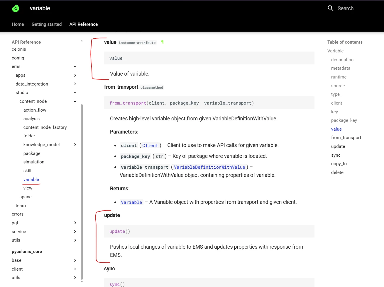

In the newest docs, I see indeed this new Package Variables described.
You should be able to adjust the value of this variable. When running the ‘Update’ function, this should be synced with your Celonis Environment, just as it works for the legacy View Variable Updates.
