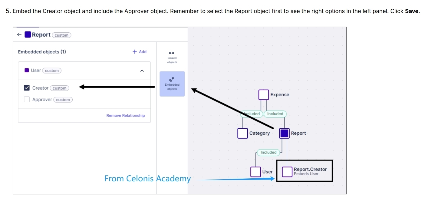

I just started 'Build your Object-Centric Data Model' course, now at the 'Create Perspectives' section, 'Embed the Creator object and include the Approver object' step.

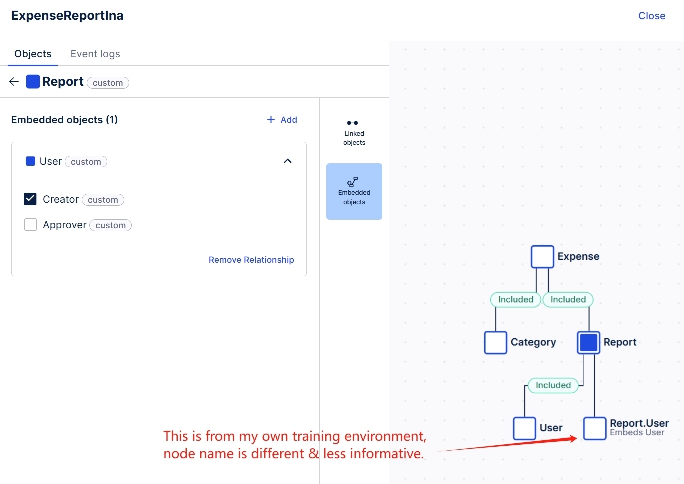

I've shadowed the steps in my training environment but notice that the node name for the embedded object looks different from the course example. In the course it shows 'Report.Creator' while mine is 'Report.User', much less informative. Screenshot attached FYI.
Could someone kindly advise why it's happening? Is it I've made some mistake, and how to make mine show the same 'Report.Creator'?

“It looks like the display of embedded names has changed since our course screenshot was taken. We suspect this change was made to reduce confusion. Whereas it previously captured the relationship name, e.g. "Creator", it now sticks to the object name only. Indeed this is less detailed on the surface but provides greater clarity as to which object is actually embedded. This is important for large perspectives.
For now, we'll adjust the course accordingly and pass on your feedback to the product team. “
